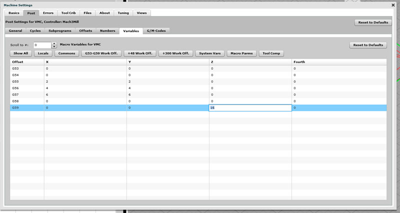

– Added support for Haas-style G154 Pxx work offsets.

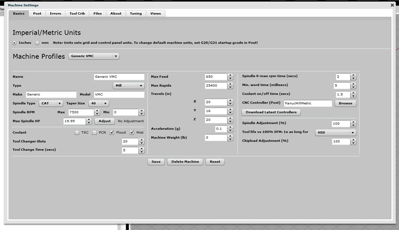

– Redid the Machine Profile so it uses screen real estate more efficiently. This should reduce the likelihood you get scroll bars when on that page.

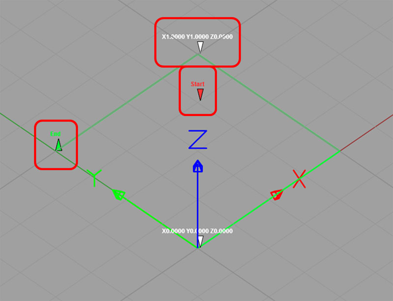

– Panning is now scaled to the zoom level of the backplot so it is much smoother and feels more “right”.
– Rewrote the axis trident position code so it stays in the lower left corner of the backplot and doesn’t bounce around so much.

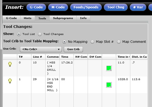

– A new column in the tool table off the Tool Tab tells the lowest Z for each tool. This is useful for determining what stickout is needed for the tools.

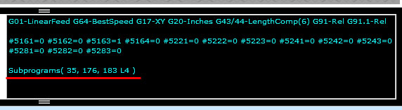

Release 1.023 adds a new macro variables tab where you can see which variables are accessed in your g-code program, their current value, and any symbolic name for the variables.

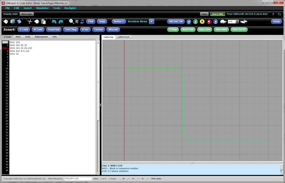

– Added support for Fanuc SETVN, which allows you to name variables and refer to them by name instead of using numbers. “#1” could be named “#HOLEDIA”, for example. There is a new post variable, “Macro.SetSN”, which should be set to “true” if your controller supports SETVN. Many do not, including many Fanuc controls. It is on by default for the Fanuc canned profiles though.
– Added a special “Soft” SETVN feature. This allows you to place SETVN statements in comments that begin with “*GWE*”. For example, suppose we have the following program:
( SETVN Test )
( *GWE* SETVN 500 [PROBEDIA, HOLEDIA, XPOS, YPOS] )
#500 = 0.010
#501 = 3.000
#502 = 0.0
#503 = 1.0
#600 = #500
#601 = #501
#602 = #502
#603 = #503
M30
It’s legal for most controls that support #variables at all, because the SETVN is in a comment. Now go to the Tools Revise menu and choose the “GWE Directives” choice. Make sure the “SETVN Do” radio button is selected and press “Apply”. The program is now transformed as though your controller supports SETVN:
( SETVN Test )
#PROBEDIA = 0.010
#HOLEDIA = 3.000
#XPOS = 0.0
#YPOS = 1.0
#600 = #PROBEDIA
#601 = #HOLEDIA
#602 = #XPOS
#603 = #YPOS
M30
You can work on it and debug the macros with variable names that are actually understandable. When you get ready to save, just run the “Undo” form of the same revision and it strips all the SETVN names back out and restores the correct numbers as defined in your *WE* comments.

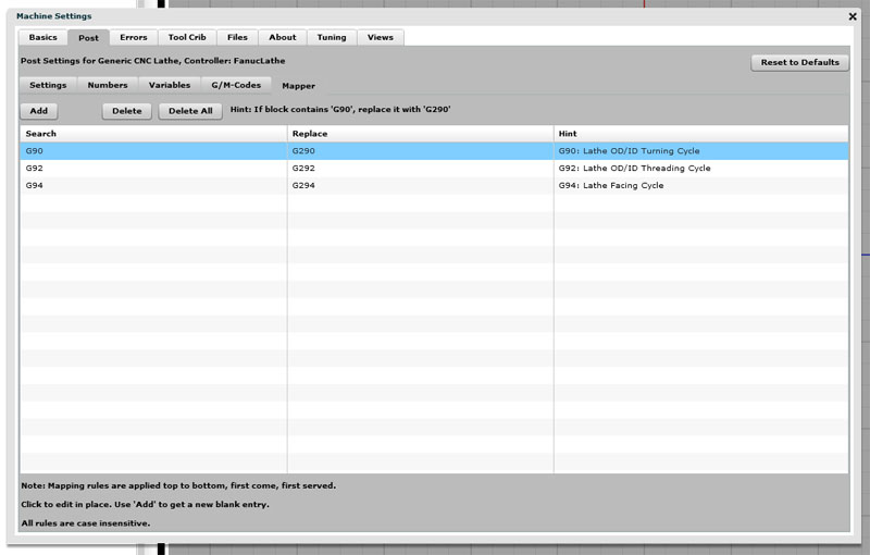

– The Post tab under Settings has a new tab called “Mapper”. Basically, “Mapper” does a search and replace at the last minute before the code is executed. This makes it easy to remap g-codes since different controls have them under different numbers as well as many other things, such as Fanuc A/B/C style lathe g-codes (coming soon!). Here is the Mapper in action changing G90/92/94 to G290/292/294:

– Added G290, G292, and G294 lathe cycles. Normally, these would be G90/92/94, but these codes need to be mapped since their normal slots are used for other things on mills, for example. So, the canned profiles use the Mapper to remap them appropriately so that programs can just refer to G90/92/94. G90 is an OD/ID turning cycle, G92 is a threading cycle, and G94 is a facing cycle.

Release 0.511 is a minor feature release. It consists of finishing up the automatic corner chamfer and corner rounding for lathes. Here is a typical example with both a chamfer and a corner round:
chamfer corner round
There are two new Post variables that can be used to enable or disable chamfer and corner round: Lathe.AllowLatheChamfer and Lathe.AllowLatheCornerRounding.

– Added markers to the backplot. There are now markers at the g-code start, g-code end, and for the g-code line the cursor is currently on:

– Added “Time in Cut” and “Distance in Cut” data to the Tool Table. This is useful for calculating tool wear information so you can keep up with when you might want to replace the cutter or how long they last for particular jobs.
– There are new visibility and color controls on the tool table. You can individually control visibility of each tool in the backplot by turning the little light bulb on or off–just click it. You can also change the feed speed color of each tool independently. Just click the color box to popup a color chooser. The rapids color remains the same for all tools. Colors and visibility status will be remembered by tool number across sessions and for all programs. You can reset the colors under the Backplot Options menu choice.
Individual tool visibility and color options for the backplot
– Radically improved the variable editing screen for work offsets. Go to Setup Post Variables and select the work offset buttons to see it. If you set up a work offset, it is saved across sessions and applies to all programs.

– A new subprogram call list (stack trace) has been added to the simulator info below the backplot. It lists the M97/M98/G65 calls by line number. If there is a repeat factor on the call, it will be reflected by an “L” after the caller line # plus the number of repeats left to execute:

– G20/21 Units: Grid is rescaled to fit the units as are the various coordinate indicators. The default is Imperial, but you can use this g-code in the Post setup g-code to change that.
– Toolholder appears miniaturized along with the yellow highlighting to show where in the backplot the currently selected g-code line is. In Debugger mode, the Toolholder is scaled fullsize to the backplot.
– The line numbers now have a “reverse out” color to make it easier to find the line the cursor is on at all times.
– Lathe diameter vs radius modes are now available for Lathe profiles. Select the option from Setup Post. When in diameter mode a “dia” will appear by the X’s to remind you.
– M98/M99 Subprogams. Style is determined in post. By default, you will be reminded that you haven’t selected a style by an error message. Repeats are not yet implemented–each call is one shot.
– Subprogram tab. There is a new subprogram tab that tells all the “O” subprogram definitions in the current file. In a future release it will also identify “N” numbers accessed via M97. You can double click an entry on this view to go to the line where the “O” is defined.
– M97 for Haas-style subroutine calls. M97 uses the “N” (block) number instead of an “O” number.
– Tweaked the editor performance a bit.
– Changed the UI of NumPost to autosave so there is no more Save button. It is saved when you exit Setup. The tab is also now called “Numbers” under the Setup Post tab.
– Quite a bit of tuning to make the auto-zooming more friendly. For example, it autozooms during debug playback and there is also a minimum zoom so it doesn’t blow things up too much when a program starts out with a few small lines or arcs.
– Broke out the options under Setup Post as tabs so you won’t have to scroll to see them.
– Did quite a lot of tweaking to improve the scroll experience, especially for the hints view.
– Fixed bugs involving the saving of number options, error messages on arc radii being too small, and many other areas.

  • Did almost a total rewrite on the Setup tab so everything (except for Metric / Imperial) now tracks the currently selected Machine.
  • Numerous tweaks to the time estimator. For example, there are new settings on the Machine Profile that are used for things like spindle acceleration time.
  • G- and M-Codes can now be disabled, ignored, or remapped to other codes. Just double click them on the Setup G-/M-Code tab.

Tools Tab:
– Changes vs List view. List is the list of tools, and Changes is every tool change.
– Comment capture. If there is a comment above the tool change, it is captured. Many CAM programs will tell you what the tool is in that comment, so it’s helpful.
– Tool List can be mapped to the Tool Crib (under setup) using either slot or comment. We don’t do anything yet with the matchup, but we will soon.
