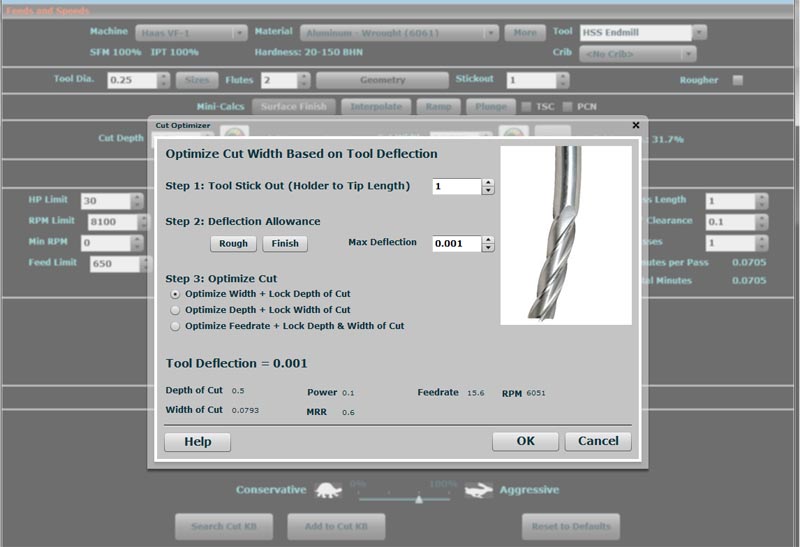

Making those kinds of decisions based on the underlying physics is what the cut optimizer is all about. It does it’s job based on Tool Deflection, and can act as a Tool Deflection Calculator. As you feed a given tool, the cutting forces will cause it to deflect to some degree. Too much feed and the tool will deflect so much that it breaks. Anyone with a CNC who ever ran the cutter into their vise with the spindle stopped at full rapids knows what I’m talking about (DOH!). But, long before you get to snapping off tools, other kinds of problems develop.
For example, if you do a little research, the major tooling companies will tell you that a tool deflection of more than 0.001″ starts to be enough that chatter can set in. If your tool isn’t deflecting much, it’s hard to see chatter, and as we know, chatter is a big determinant of the outer edge of how hard we can push a machining operation. So, the Cut Optimizer takes a deflection of 0.001″ as being the maximum allowed when roughing. By the way, how accurate is your machining going to be if you let the tool deflect my more than a thousandth anyway? You can set the Cut Optimizer to home in on any deflection you desire, a thousandth is just the recommendation for roughing.
Now let’s say you are finishing. Tool deflection playes a role here too. If you have too much deflection, you’ll see more marks on your workpiece as the tool flexes. Also, when we’re finishing, we are even more concerned about accuracy. Because of this, G-Wizard sets a limit of 0.0002″ on tool deflection while finishing. Again, you can override that limit, it’s just a starting point.
Let’s say you’ve set your desired cutting parameters, set the allowable deflection, and you’re running the Cut Optimizer, and you just can’t take as aggressive a cut as you need or would like to. The Cut Optimizer has a further capability to lock down the cut width and cut depth and vary the feedrate to try to hit a deflection allowance. Note that there is a limit to how much we can slow down the feedrate. If we let the chipload fall too low, the tool will start rubbing, and tool life will suffer greatly. Towards that end, the Cut Optimizer will only reduce the feedrate to a certain point and then it stops.

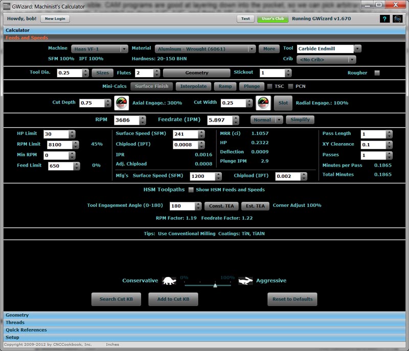

Check out this screen shot of the Feeds / Speeds tab:
The Cut Optimizer is activated by an icon that looks like a little speedometer.  I have circled them in red on the above diagram.
Using Cut Optimizer is simplicity.  Just click the icon next to the value you want to optimize and Cut Optimizer will find the largest value for that parameter that does not trigger a Deflection Warning.  No popups or further interaction required.  Just one click.
For example, let’s suppose you know you need to do some slotting. Press the “Slot” button to set the Cut Width to be the tool diameter. Then press the Cut Optimizer button next to Cut Depth. This causes the Optimizer to figure the maximum Cut Depth that’s possible while slotting. Or, choose a depth, perhaps because you’d like to cut a pocket at full depth in one pass. Then press the Cut Optimizer button next to Cut Width and the Optimizer will tell you the maximum Cut Width (stepover) that can be used within deflection limits.
