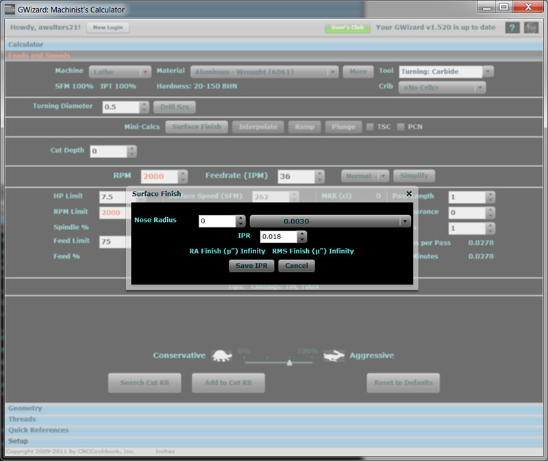

Lathe Surface Finish Calculator
For turning operations, you can pop up a surface finish box to determine feedrates based on desired surface finish given a particular cutter nose radius.
This is one of those features you won’t find if you are using a free simple lathe speed and feed calculator.

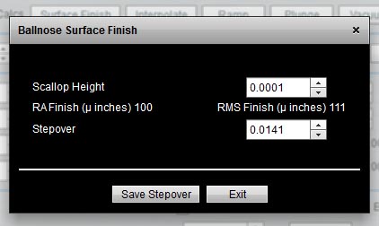

Mill Surface Finish for Ballnose 3D Contouring Calculator
If you’ve selected a mill for your machine and ballnose geometry for the cutter, the Surface Finish mini-calc will help you determine stepover for a particular surface finish:

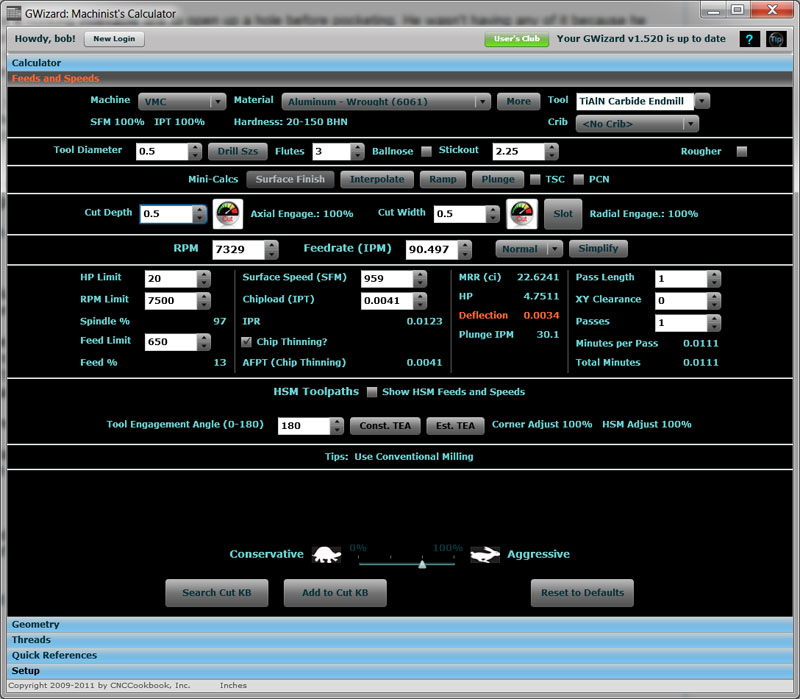

From the screen shot above you can see I’ve set up an aggressive machining scenario in 6061 aluminum. I’ve got a 1/2″ 3-flute TiAlN Endmill selected and it’s a serrated “corncob” rougher to boot. I want to set up my CAM program to cut a pocket on a part, and I’ve decided my entry to the pocket will be via ramp. I’ll show how to use the Ramp Mini-Calc to solve a couple of interesting problems.

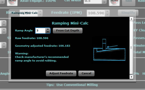

First, let’s say I just plan to ramp down at some “standard” rate, say a 3 degree angle. What should my feeds and speeds be on that ramp? You should adjust your feeds and speeds slightly when ramping because its harder than making a level cut. Let’s say we’ll be cutting our pocket at a 1/2″ depth. Set up for a full slot cut, because the ramp will be descending into bare metal. Let’s also set the depth of cut to be the maximum depth of the ramp in one pass. If we need to go deeper to get down to full cut depth, the ramp will zig zag back and forth. I’ll use a 1/2″ depth of cut at full ramp. Here is the Ramp Mini-Calc with all that keyed in:
Ramping the Cut Down 3 Degrees
Ramping the Cut Down 3 Degrees…
As you can see, with a 3 degree ramp, the adjustment in feedrate is pretty minor, from 108.6’ish IPM down to 106. No biggie, in fact we could probably just choose to ignore it unless we’re running a really max’ed out feedrate we’ve determined through trial and error to be right at the ragged edge.

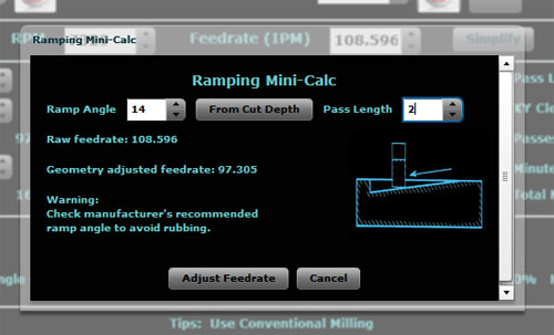

What if we want to see what angle is needed to get all the way down the ramp in say 2″ of travel? No problem. Set your depth of cut as before to the bottom of the ramp, bring up the Ramp Mini-Calc and press “From Cut Depth”. You’ll see a new control appear that wants to know the travel length. We’re trying to get there in 2″, so fill that in:
You need a 14 degree angle to ramp down 1/2″ in a 2″ pass…
The Ramping Mini-Calc figures the ramp angle at 14 degrees. This is more aggressive than the 3 degrees we had earlier, so we have to cut our feedrate from 108.6 IPM down to about 97 IPM. That’s starting to be worth worrying about in the CAM program. You can just click “Adjust Feedrate” and the Mini-Calc will override G-Wizard Calculator’s default calculated feedrate based on the new information on ramp angle.
This is a probably a good time to mention the warning you see there. Not all cutters can tolerate arbitrary ramp angles. For example, let’s say we had a 90 degree ramp angle. That would be a straight plunge. Obviously if you don’t have a center-cutting endmill, that’s a no-no!
Insertable tooling will have a ramp angle limitation that you can find in the manufacturer’s catalog. It’s often pretty limiting, so be sure you don’t find out the hard way you have exceeded it!

Plunge Roughing is an extremely effective roughing strategy for cases where rigidity is limited. This can be because the machine is light or because the reach needed is very long. In Plunge Roughing, we mill straight down. One could regard chain drilling with a cleanup pass as an early form of plunge roughing. These days, we can plunge rough with twist drills, but it works better with milling cutters as the drills don’t like partial holes.
Let’s say we have to mill a small pocket that is 2″ deep. Moreover, the geometry is such that this has to be done with a 1/2″ endmill. That’s a recipe for rigidity problems as we can see when we first dial it up in G-Wizard:
No plunge feeds
Deflection is huge with a 2.25″ stickout on a 1/2″ endmill…
The deflection is huge–0.0034″. It’s tough to deal with a 2.25″ stickout on a 1/2″ EM, even though we’re only cutting 1/2″ deep per layer. If we run the Cut Optimizer and lock both Cut Width and Cut Depth, it wants to back the feed off all the way to 25 IPM to get rid of the deflection.
