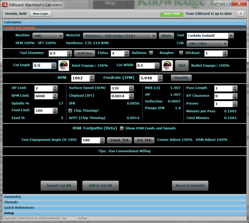

Accessing the Cut KB
The Cut KB is accessed via two buttons at the bottom of the Feeds and Speeds tab:
Accessing G-Wizard's Cut KB
The Cut KB is accessed via the “Search Cut KB” and “Add to Cut KB” buttons at the bottom of the tab…
To add new entries to your Cut KB, press the “Add to Cut KB” button.
To search or edit your Cut KB, press the “Search Cut KB” button.

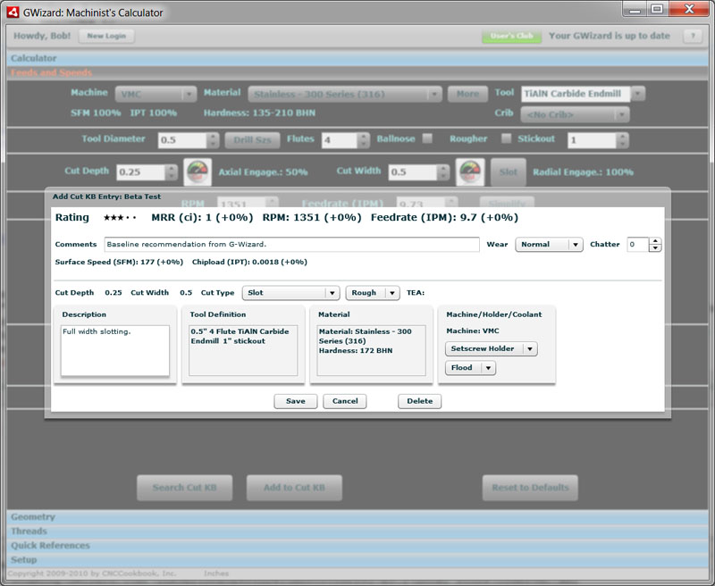

Adding Entries to the Cut KB
Before you can do much with the Cut KB, you have to add some entries to it. You should only add entries that represent the parameters for cuts you’ve tried in real machining operations. To create an entry, fill out the G-Wizard Feeds and Speeds tab with the parameters of your cut and press the “Add to Cut KB” button. Be sure you have the cut just the way you want it before pressing the button as you won’t be able to change anything accessible on the Feeds and Speeds tab from the “Add…”, it just copies the values from Feeds and Speeds.
When you press “Add…”, you’ll get a popup like this:
Adding an entry to the Cut KB
Adding a Cut KB Entry…
While the information covered on the Feeds and Speeds tab may not be edited in the popup, a number of new pieces of information are there that are designed to help you do a better job describing the results of the cut as well as the conditions.
For results you get to specify:
– A rating from 0 to 5 stars. This is your subjective rating of the usefulness of the cut. The example shows three stars. Just click on the slot for the number of stars you want to assign.
– A comment. I’m saying that this cut was run with the vanilla recommendation from G-Wizard.
– An assessment of the wear on the tool. Possible values include “Normal”, “Poor”, “Chipped”, and “Broken”. If you try a cut that is problematic due to wear of some kind, be sure to document and save these cuts in your KB as well so you can avoid them in future.
– An assessment of any chatter encountered with a rating from 0 (None) to 5 (Bad). Chatter is a reproducible phenomenon and Cut KB is an excellent tool to help you master chatter.
– The Cut Type tells what kind of cut was being attempted. There are different values available for mills and lathes:
For mills:
  • Peripheral milling is done around the outside of a part.
  • Pocketing is done somewhere in the middle of a part. If your profiling did not involve cutting air outside the part and the cutter was fully engaged in the material at all times, you should log it as pocketing because there is no difference to the cutter.
  • Slot milling is one of the most demanding operations involving cutting with the full width of the cutter at some depth. Ramping the cut down via a CAM program is also a Slotting operation.
  • Helical milling is used to spiral down and begin a CAM toolpath or to interpolate a hole.
  • Facing is a surfacing operation.
  • 3D Profiling is often done with a ballnosed end mill to create a 3D surface.
  • Boring involves the use of a boring head.
  • Drilling is an operation with a twist drill or other holemaking tool besides helical interpolation.
  • Other is the catchall for operations not listed. If you use “Other”, try to tell what the operation was in the Description area. For example, “Engraving”. You can then use a keyword search to find these operations.
For lathes all the normal operations are there:
  • Turning
  • Facing
  • Parting/Grooving
  • Threading
  • Boring
  • Drilling
  • Other
– The Rough dropdown allows you to designate the cut as either a roughing (meaning the emphasis is on MRR or similar roughing goals) or a finishing (meaning the emphasis is on surface finish or accuracy) cut.
– Description is a place to add any keywords or description of the cut that helps clarify its purpose or use.
– Holder is where you specify what kind of holder was used with the tool. Choices include ER Collet, TG Collet, Setscrew Holder, Hydraulic, Milling Chuck, Tribos, Shrink Fit, Drill Chuck, or Floating Tap Holder. The type of holder has a huge impact on the performance of your tooling.
– Coolant is the last choice you can record. Choices include Flood, TSC (Through Spindle Coolant), Mist, Air, and None.
Note that you’ve probably changed things from what G-Wizard recommends as part of looking for more performance. That’s no problem. The Cut KB expects you to have overridden some aspects of the cut, for example the RPM, Feedrate, Surface Speed, or Chipload. Just go ahead and type in those overrides before pressing the “Add…” button.
When to Add Entries to the Cut KB
You’re certainly encouraged to add an entry for every cut you try. It’s best not to enter “theoretical” cuts that are untried because you will have no way of knowing what results (such as chatter, wear, etc.) to assign to such cuts.
What’s most important is to add cuts that represent extensions to the envelope. Cuts where you’ve gone successfully faster than ever before and cuts where you went too fast and failed are the most valuable to have available. The failures will help you define future experiments, which should involve running more slowly (although not always, if you’re familiar with stability lobe diagrams and chatter, sometimes its better to crank it up further if a cut is failing due to chatter).

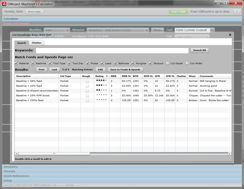

Searching the Cut KB
Let’s say you’re sitting in front of your CAM program and you want to use the Cut KB to determine the best possible feeds and speeds for a particular operation. Your first step is to enter all the relevant parameters for the cut in the Feeds and Speeds tab. Next, press the “Search Cut KB” button to see what’s available.
Let’s say we’re trying to do some pocketing in stainless steel with a 1/2″ TiAlN 4 Flute endmill. After entering the various parameters in Feeds and Speeds, we press the “Search Cut KB” button and up comes the result of our search:
G-Wizard Cut KB Search
The Cut KB entries that match the Feeds and Speeds parameters…
G-Wizard goes out to the Cut KB and retrieves the entries that match based on any keywords you enter together with matching the values from feeds and speeds that are checked off in the check boxes. In this case, 5 cuts had been recorded in the KB for us to consider. Clicking the rating column lets us rank them by star ratings. The best cut achieved an MRR 54% better than the G-Wizard recommendation and was achieved by bumping up the feedrate 54%. You can see there were two failed experiments shown at the bottom of the list (no stars!) as well. In one case, bumping the rpm’s resulted in a chipped cutter. In the other we went too far with the feedrate and broke the cutter.
Note, these numbers are simulated. You have to do real experiments on your machine or there are just too many variables that are unknown. That’s the power of the Cut KB–it’s all about helping you control more variables to achieve greater cutting performance.
Editing and Deleting Cut KB Entries
Editing or deleting a record couldn’t be easier. Just double click any record visible in the search results and the edit box pops up. There is a delete button there to get rid of unwanted results.
