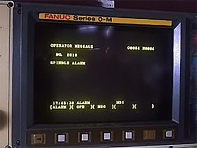

Spindle Alarm!

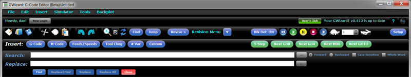

Find and Replace
G-code programmers use find and replace a lot, so it's important to have a good one. CNCCookbook's G-Wizard Editor uses a special Find/Replace toolbar to make find/replace into a true power tool. With the toolbar, there is no popup obscuring part of your program that you have to peer around. You can seamlessly move back and forth between editing and find/replace as you move through the program. Accessing Find/Replace is easily done with the mouse via menu or toolbar and from the keyboard simply by pressing Ctrl + F.
Find/Replace Toolbar is easier than peering around a popup dialog...

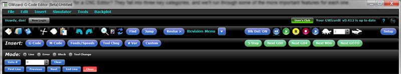

Jumping in a G-Code Program
G-code has a pretty regular structure, and some features in it are so important it's worth having a special "Jump" command to move through that structure. For example, you may want to jump to the next g-code "N" block number, actual line number (e.g. N10 might be on the 1st physical line), next error in the program so you can fix it, or to the next Toolchange. Like Find/Replace, it's convenient to have Jump as a toolbar rather than a popup dialog, and it is convenient to access it either with the mouse or the Ctrl + J keyboard shortcut.
Jump toolbar...

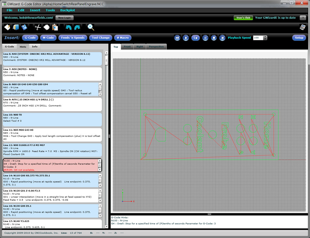

Hints: G-Code in Plain English
Hints are a feature that explains g-code in plain English. This is helpful for learning the g-code as well as for getting a refresher on the details you may have forgotten, and for collecting information that is otherwise not obvious. In the G-Wizard CNC Editor, you can view the Hint for the currently selected line of g-code, or you can switch to the Hints tab and see Hints for all the lines laid out together.
G-Code Hints
Hints View shows you a quick explanation of what the g-code does and it also shows error messages. For example, the current post does not support the G4 used in this program...

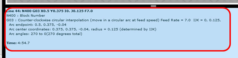

Here is a typical example of a Hint for a line containing an arc:
G-Code arc information
Line N400 has an arc. The Hint below the backplot tells all...
Suppose you haven't learned arcs yet, and are trying to follow the line of g-code:
N400 G03 X0.5 Y0.375 I0. J0.125 F7.0
The fact we don't yet know how arcs work makes the Hint even more valuable. Let's take a close look at the Hint:
Arc Hint details
The Hint for an Arc...
It tells us the following:
- In bold at the top is the original text of the line. This is useful if we're in Hints view and can't see the g-code line text.
Right below the bold, it starts telling us all about what the line does:
- The Block Number is N400
- G03 performs Counter-clockwise circular interpolation. In other words, it tells the machine to move the cutter in a circular arc at feed speed.
- The Feed Rate was set to 7.0 on this line.
- We see what the IJK values parse to be. In this case, we have I=0, J=0.125, and no K
- The endpoint of the arc after the move is 0.5, 0.375, -0.04
- The coordinates of the center of the arc are 0.375, 0.375, -0.04.
- The center was determined by IJK (as opposed to R, which is another way)
- The angle of the arc runs from 270 degrees to 0, a total of 270 degrees.
After all that, the Hint skips a line and gives us a time. This is telling us how long it will take the g-code program to reach this line and finish it if we execute on the machine. In this case, we can see the arc will be completed 4 minutes and 54.7 seconds after the program starts executing.
Phew, that's a lot of data spewed forth, but it can be extremely handy to have when you're trying to figure out what a g-code program is doing or what's wrong with one. And, like I said, it's hard for an expert to tell all of this stuff at a glance.
GWE gives this level of detail for each and every line of the program.

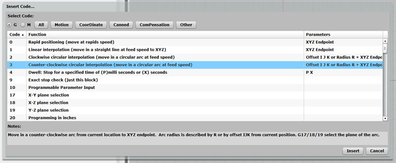

Wizards: Remembering the Details for you
G-Code is powerful, but it is also somewhat arbitrary. Wizards are there to help you overcome the arbitrary part by remembering the details for you. If Hints are there to help with reading G-Code, Wizards are there to help with writing G-Code. In G-Wizard CNC Editor, the Wizards may be triggered either via Toolbar with the mouse or via Keyboard shortcut:
G-Code Wizards
Select from 6 different Wizards on the Toolbar for G-Codes, M-Codes, etc...
After you've chosen the Wizard, it pops open with more options. For example, here is the G-Code Wizard:
G-Code Wizard Popup
The Popup Wizard for G-Codes...
From the Wizard, you can just key in a number directly: for example, type Ctrl + G then keep typing "3" then enter and a G03 is entered. If you get in the habit of typing "Ctrl-G" instead of just "G", the Wizard will be there to catch you if you forget how the code works. If you close your eyes, you'd never know it was there. Once it's up, you can scroll through the options, look at them by category (e..g "Motion", CoorDinate", etc.), see what parameters are used, and also see the hint information (under "Notes") associated with that G-Code.

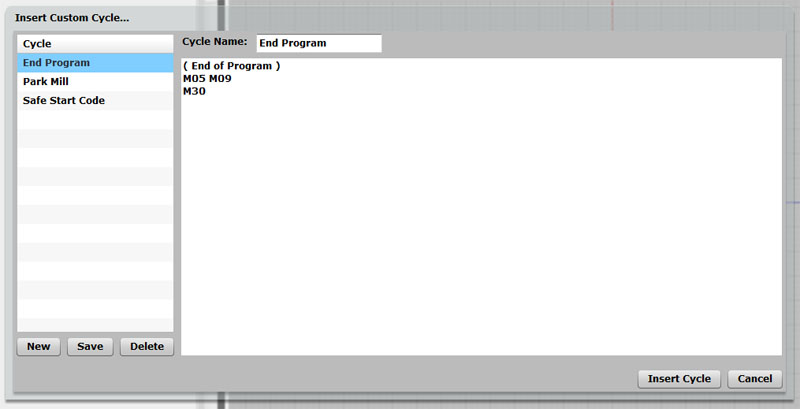

Code Snippets as Custom Canned Cycles
Over time, you're going to build up a library of code snippets that you like to use when programming. G-Wizard makes it easy to manage these as "Custom Cycles". Just click the "Custom" Wizard and you'll see how it works:
G-Code Custom Canned Cycles
You can create new cycles, edit the existing ones, or insert the code into your program. GWE provides three default cycles for you to start with:
- End Program: The set of steps you want to do at the end of every program.
- Park Mill: It's nice to configure some code that "parks" the mill table for easy loading and unloading by the operator.
- Safe Start Code: The steps you want to begin every program with so it starts out in a known safe state.
